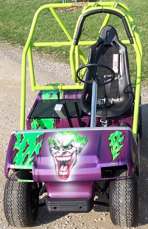

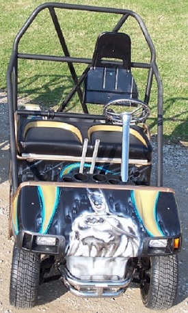

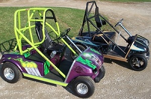

Here's the 540 (Joker) cart Zappy. Still have more detail work to do. But I had built the 440 Yamaha a couple years back. It was a extra backup cart. I sold it to a friend not long ago and he came up with the idea to paint the carts with the Batman and Joker. What were shooting for doing some exhibition wheelstanding match races. Or take them to car shows and do some one wheel tire smoking burnouts. The guy that painted the bodies does some excellent air brush work for the price. Amazing!
Batman & Joker Carts 002 Copy.jpg (240.11 KiB) Viewed 50958 times
540 cc
440 cc
Batman & Joker Carts 004 copy.jpg (243.12 KiB) Viewed 50958 times

Love the fire commin out the zoomies on the side. 8) 8) Wheelstand match race is GREAT, and the car showes.

Very cool, like the theme! 8)
