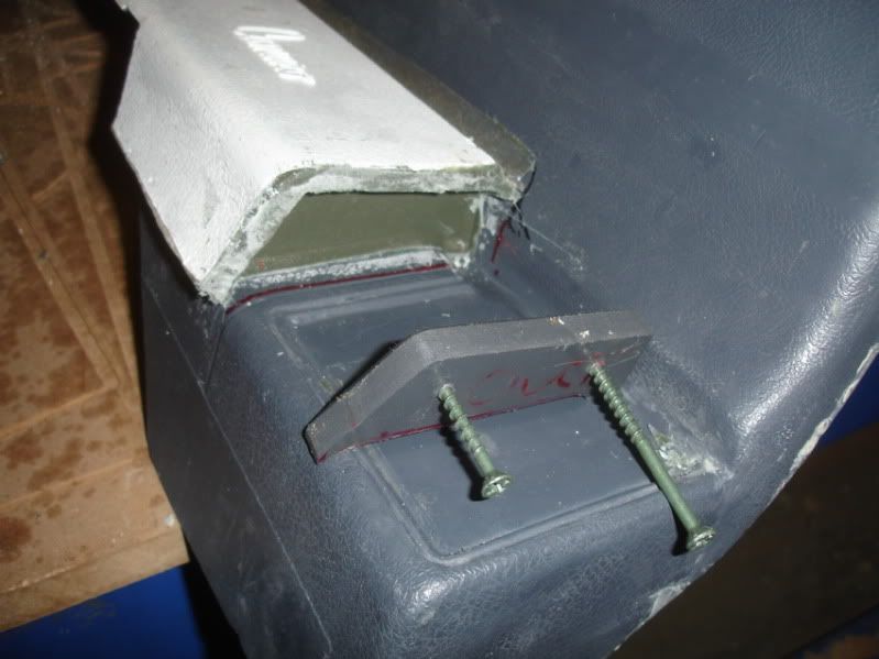

It's a little thing but I did some work on the "Z" tonight. I glassed the glove box door on the dash.
The door is thin & I was worried the edges might get bumped & crack. So, I taped it off, dumped some more of that kitty hair stuff behind the door & shoved a plug in the goop. When it started to set up I trimmed the excess & pulled the plug.
Not a big deal but it but it makes it look a little more beefy. A little finish work & nobudie' will ever know there is an icebox in dare;. :wink:

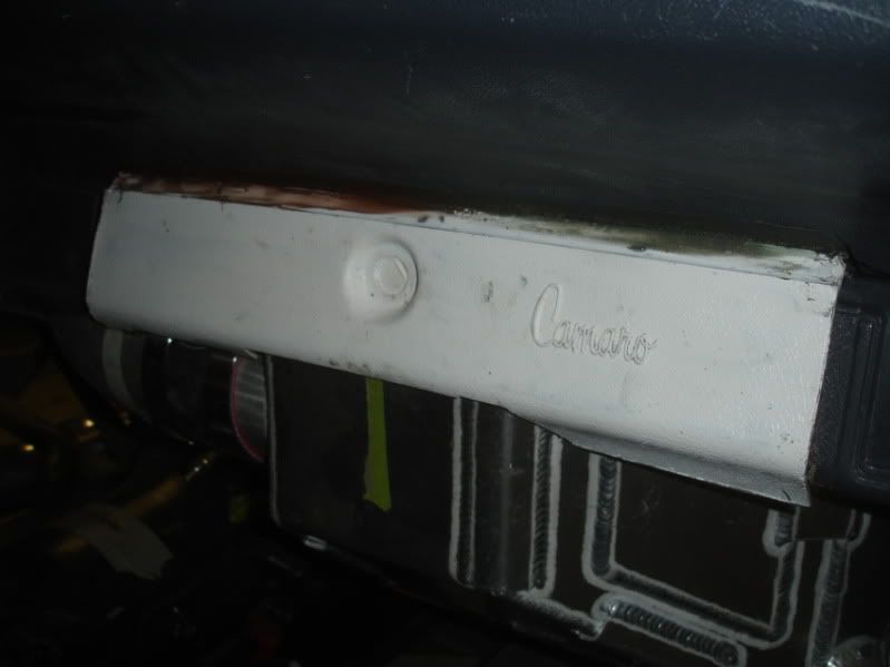

Kinda' has that "Door Ajar" LQQK. :lol: That's a closed as it gonna' get. :wink:

I get a few minutes here and there. I used my last window of opportunity to clean up all the overlapping layers & protruding tabs on the glove box back side & give it a couple reinforcing layers of cloth.
Little more cleaning up on the front. Got a few spots to touch up around the glove box, dash bezel opening & the steering column & then it's ready for primer.
