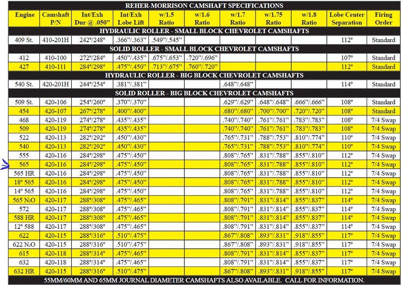

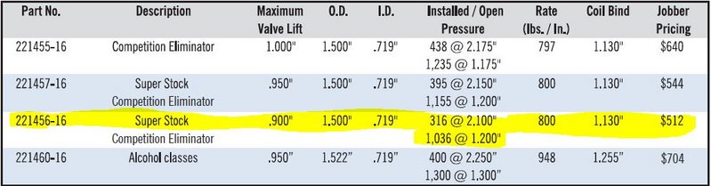

The engine is a BBC 565 TD NA on E85.
Cam is a Reher-Morrison 420-116. Springs are Manley Nextek. See attachments for the cam & spring specs.
RM cam.JPG (218.32 KiB) Viewed 83765 times
Also, I know how to check them and know how to change them. I just don't have the tools to handle springs of that stiffness. I was just wondering what you guys use and if you would buy them again.

WOW,..!!!! Thats alot of spring on both sides,...and for N/A.... are you shooting nitrous into your motor or something..???
Im surprised you dont have a 1.625 or larger spring diameter for that motor,...your cam is really close to mine.
