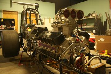

Just wanted to get an idea on what plugs to start out with. I have a 505 BB Chevy with Enderle injection on alky,Dart 320 heads Crane roller cam .730,13:1 compression. This is all new to me as I come from the dirt tracks.
BB Chevy 010.jpg (72.43 KiB) Viewed 135467 times

J85,...
I run NGK`s on my BBC 505 NA stack injected on alky w/Dart Pro1cnc335 12.95-13.0 compression,. they work great
stock #4554
part# R5671A-8
I run a Vertex mag making 5.2 amps and use a plug gap of .020 and timing at 36*
I see you have a 7AL-2, I would gap about .026-.030
Where are you running your car ??,..and when....you putting a flopper body on that, or altered ????
looks great , and good luck.
Vic

Postby j85 » Thu Mar 18, 2010 1:49 pm
Will be a 23T Altered.I just wanted a car that would give me a thrill. I have not drag race before so this will be an experience for me. I will be running KCIR in Kansas City,Missouri and Heartland Park in Topeka and do some travel. I really appreciate your advice.
Is that your car ? If so awsome looking car and what memory's :shock:
Re: Spark Plugs ?
Postby Billy Mac » Thu Mar 18, 2010 1:54 pm
Yup...That's Vic's toy....and Yes...it WAS Ken Veney's! 8)
