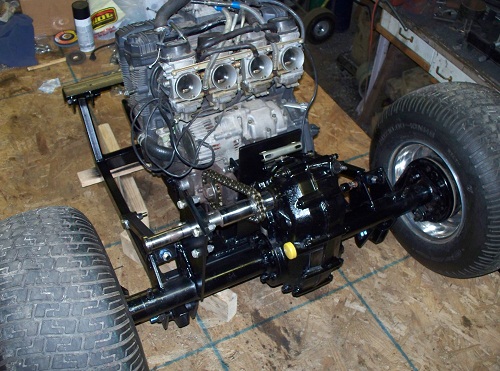

Really don't know why I'm building this. I guess it's the gearhead in me and I do love a challenge and love putting my idea's together, so what the heck, why not.
This is intended to be the next CCM wheelstander. Powered supplied by a water cooled GSXR 750cc Suzuki. So far I have the swingarm built and the rearend is connected to the engine. Next will be trying to build a setup for the clutch cable, mount for the radiator and then the dreaded wiring.
Since my right hand will be steering and I like to have my left hand on the steering wheel, I come up with my own electric shift setup activated by a rocker switch on the steering wheel for up and down shifting. I used 2-50# shaved door handle solenoids mounted on the shift rod on the trans. Tested on the bike before I pulled the engine and it worked. Hopefully it will work on the cart. Will see! I know I can't hardly wait drive it!!
Speed? Installed a 17 tooth sprocket on the engine and a 11 tooth on the rearend input shaft. I think with the stock cart rear gearing of 13:1, red line on the engine at 13500rpm and with 20" tires, speed will be around 50mph. Looking for more of a WOW factor and noise for shows, not speed.
750cc cart build 003.JPG (237.47 KiB) Viewed 57854 times
