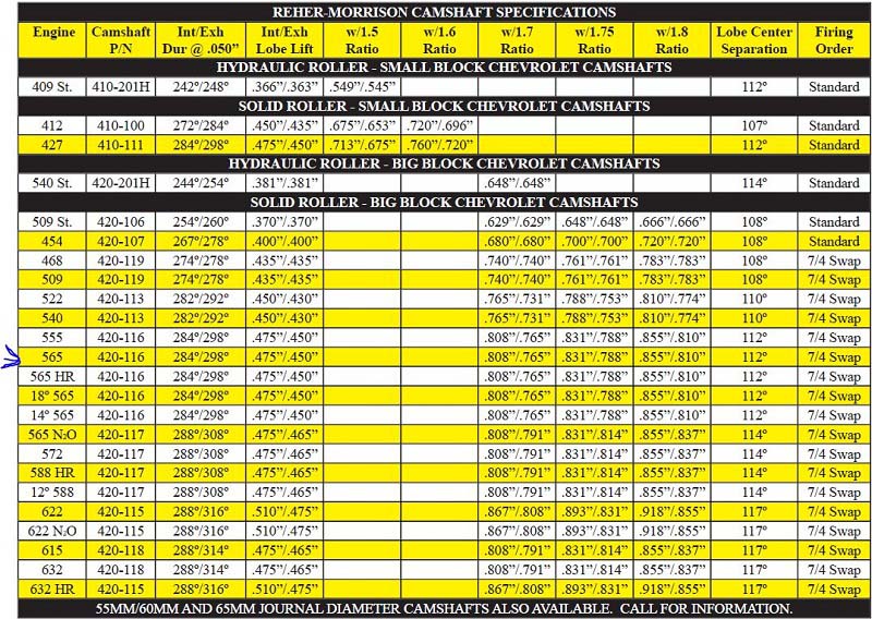

The engine is a BBC 565 TD NA on E85.
Cam is a Reher-Morrison 420-116. Springs are Manley Nextek. See attachments for the cam & spring specs.
RM cam.JPG (218.32 KiB) Viewed 83812 times
Also, I know how to check them and know how to change them. I just don't have the tools to handle springs of that stiffness. I was just wondering what you guys use and if you would buy them again.
